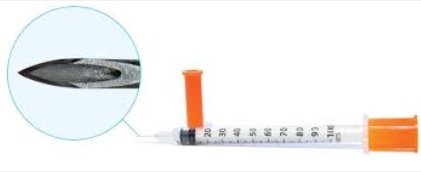

As shown on the pic the needles of the syringes bend very easy. The tiny little needles on the insulin syringe U100are not made to penetrate the septum (rubber stopper) of the peptide vial. They will be dull or bend after that and will cause much more tissue-damage and pain.
Although HGH can be mixed and injected with any type and size of syringe, the insulin type syringes are the most suitable. If possible get the ones with 100 markings on the side. It will make it easier to properly determine the dosage of HGH.

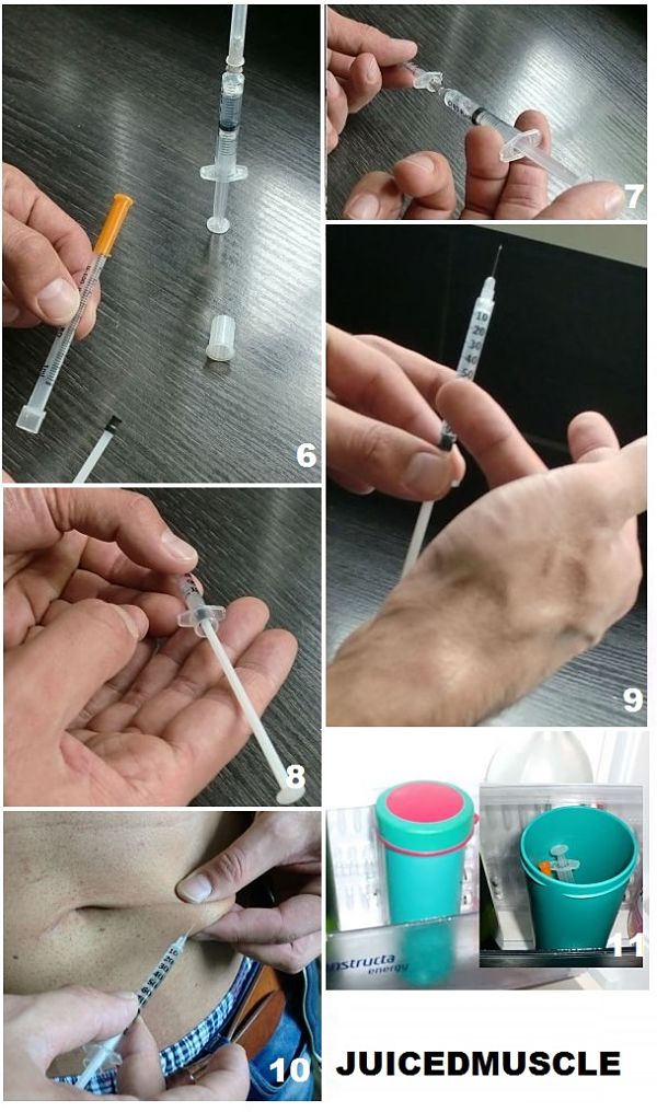

6.) Pull the plunger out of the insulin-syringe and put it aside on a clean place.
7.) Slowly inject the reconstituted somatropin into the back of the U100 insulin-syringe.
8.) Close the back of the insulin-syringe with the plunger and rotate the insulin-syringe needle up.
9.) Now tap with your finger gently against the insulin-syringe until the air moves from the bottom of the syringe to the top. Now push the plunger upwards until you see a drop of liquid pushed through the needle. Now you syringe is ready to use.
10.) Growth hormone can be injected intramuscularly (IM) into pretty much any muscle or subcutaneously (SQ) - under the skin in the stomach fat area. Injections above the belly button are usually less painful than the ones below the belly button. A different spot should be used for each injection (to avoid potentially producing dents in the body fat - as hgh is believed to promote localized fat reduction).
For SQ injections, clean the skin with alcohol, wait a bit, then pinch the skin between your abs, fully insert the needle at a 30 - 45 degrees angle and inject your dose. For IM injections fully insert the needle into your shoulder or gluteus muscle and release the dose.
It is rumored that the SQ injections produce better effect due to the fact that HGH is more readily available from there. Personally I see no difference whether I inject IM or SQ. Injecting HGH intramuscularly is less unpleasant for me, so that's how I do it.
11.) I keep all syringes in a closed plastic container in the refrigerator door.
